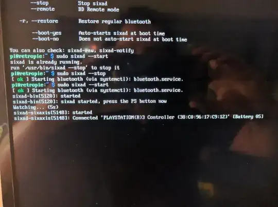

- I've tried running sudo ./sixpairfrom a shell connection following the steps listed here

UPDATE
See my comment below the accepted answer by @Donny V, but I was able to get this working by using the gasia drivers.
The reason this worked for me was because I accidentally purchased a cheap Chinese knock-off controller!  I was able to figure this out based on this discussion on the RetroPie forum.  Basically, run the dmesg command and I was able to see the manufacturer of all connected devices.  Seeing the devide name of my controller was SZMY-POWER CO.,LTD. PLAYSTATION(R)3 Controller - note that it's not made by Sony!
