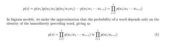

There's a footnote in Jurafsky & Martin (2008, p.89) pointing out that, without an end-symbol, an n-gram model would not be "a true probability distribution". Even after seeking the paper they've referenced, I could not get the point. Here is the example and the footnote:

I found the paper Chen and Goodman (1998).
bi-gram is just an approximation of n-gram.

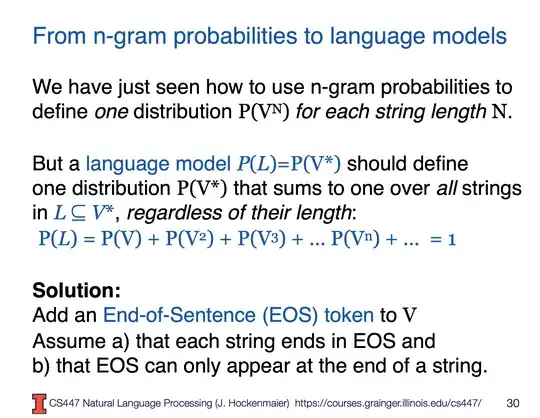

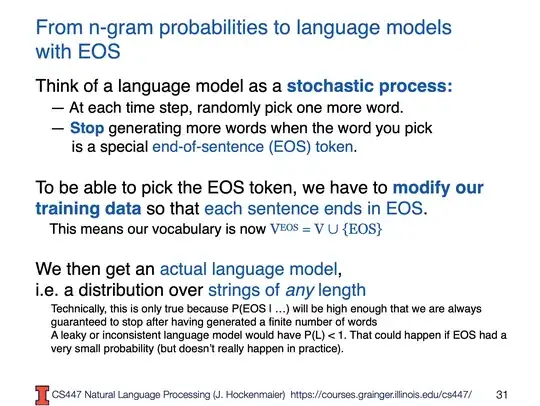

helpful deck: https://courses.grainger.illinois.edu/cs447/fa2020/Slides/Lecture03.pdf enter image description here enter image description here

  1. Without a eos marker: We're compelled to this definition:
A sentence of length n is a word sequence of length n.
As @Draconis pointed out, there's no real difference between a n-long word sequence and a n-long sentence! This is what causes the problem here. The sum of probability of all sentence of length n is equals to 1, which is something we don't want because we want the model to output something more useful: the probability of a n-long sentence in the sample space of all sentences(arbitrary length), not in the sample space of sentences of length n.
  1. With a eos marker(game-changer): We have the new definition of a sentence:
A sentence of length n is a word sequence of length (n + 1) with the last word being eos
Problem solved! The sum of probability of all sentence of length 2 is now:
$\sum_v \sum_w P(v,w,eos) <= \sum_v \sum_w \sum_t P(vwt) = 1$. So are sentence of length n
