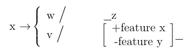

Results in:
You can see that output and environments are centered. Is there any way to un-center them and/or left-align them? The centering that it does appears to be an intentional addition in v1.2.0 of phonrule. But there is nothing else in the documentation regarding alignment.
I need it to be the standard left-aligned version - that is, left-aligned output and left-aligned environment. Something like this (exact spacing is flexible):
Trying to throw in any type of alignment generally breaks the phonrule environment and it won't compile or it aligns the entire figure/example, rather than just the individual (output + environment) sections.

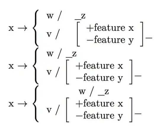

The changes are:
  1. The \oneof command accepts an optional argument for the inner alignment, default c like in the original; it can be l or r.
  2. The commands \env, \envl, \envr and \envb have a *-form, which inserts an & after / instead of the default ~, so they can be used in the argument of \oneof in order to get the alignment you wish.
In the code above I used all three possibilities; the first example is what you're looking for, the second one just has left alignment, the final one is like the original.
