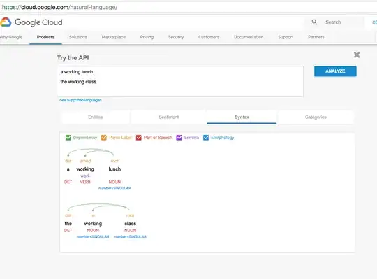

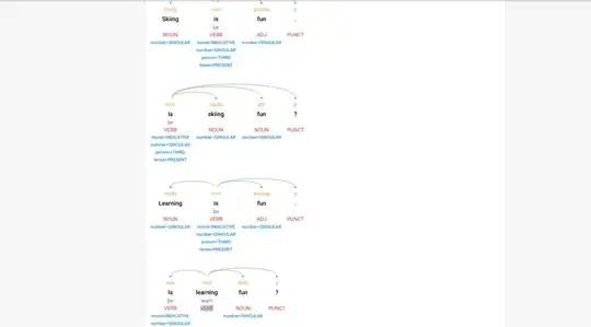

Another way to deal with it would be to add an additional field for the original part of speech, and for the models to learn both and their APIs to expose both. That would not be too hard.
The hard part for such systems, because the combinations may appear less in the data and it can require real intelligence to disambiguate, is to distinguish the noun use from the adjective use
For example inside of a noun phrase:
There are holes with regard to noun use versus verb too:
N, N, N... and then V, whether we try the Google service or the open-source spaCy library.
