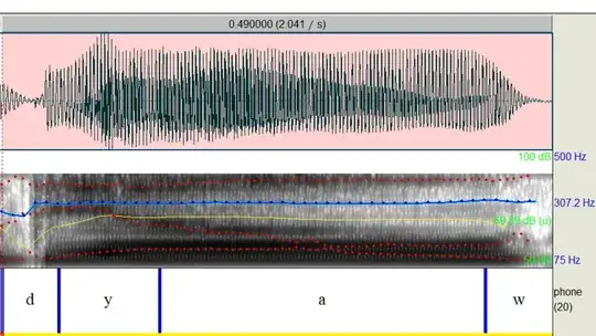

I'm currently labelling some singing data, which contains very slow transitions between vowels. The data often have prenuclear glides and diphthongs together. The picture below is an instance (the correct IPA should be [ti̯ɑʊ̯]):
[ti̯ɑʊ̯]
If I understand correctly, from the /i/ sound to /a/ has a transition with the shape of a ">", since /i/ has lower F1 and higher F2 than /a/; from /a/ to /u/, the shape is the other way round.
However, the descending or ascending slopes are just the transition periods. How do you decide where to put the boundaries? Are there textbooks or articles discussing such issues? Should I put the boundaries in the middle of the transitions?

  • It's not useful to denote a precise start and end point, is it? You rather denote articulatory features in the signal, so you'd better ask a trained singer. Also, middle is not a precise term, because different measures exist (arithmetic mean over time, power, frequency; median; I don't know, I'd wonder what signalprocessing.se would say), which implies that it doesn't make a difference as long as it is consistent. – vectory Jun 05 '19 at 17:41
  • @vectory why did you say it's not useful to denote the precise start and end points? I was trying to figure out some durational patterns of the phonemes, so I need to make some decisions. I understand that it's impossible to find the precise points but i was wondering whether there was any conventional ways of dealing with such cases. Like how did people who study durations in connected speech decide where to put their boundaries? I haven't really found any paper that has such details. – SuperDuperMario Jun 06 '19 at 06:34

Only a proposal:
The problem seems to be: having a clear definite point to determine whether you are in one vocal or another for example.
As you said you could define transition zones. And then take a temporal "barycenter" of those zones as the discrete transition points so to base your calculation of durations.
My point is: You can get some inspiration from Fuzzy Logic, which helps a lot with the need to describe a quality / a feature that is not a discrete value. I think it is exactly the case for phonems.
As you highlighted with your varying frequency curves, and when looking at the IPA diagram, it is clear that the space between vocals is totally continuous, and not discrete:

I was not using formant frequencies like you seem to do (that's what I interpreted from the graph).
