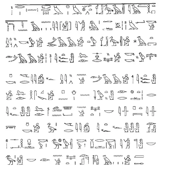

I am trying to transcribe some images of illustrations of hieroglyphics into Unicode. I am having a hard time and right off the bat there seem to be slight variations in the structure of the hieroglyph. For example, in the illustration attached, the first ellipse has a line off to the side, while the one on Unicode has either 2 lines or no line . Then the bird, how do you pick a bird?

But then you see a bird like in the image on the attachment, and then go like "How do I decide which bird is the right one?"
So my question is, how would you take the image below and make it into Unicode? How do you know you're picking the right one, even though there are such slight variations in the Unicode hieroglyphs like the birds, and also in the drawings like the attachment shows (comparing its glyphs with Unicode).

    I think you need a background in Ancient Egyptian to pursue this task. You have to know and recognize the hieroglyphs (probably including the contexts of the works you’re transliterating) to encode them properly. Unicode characters all have English names; if you knew from the hieroglyphs what you were dealing with, you’d be able to encode them. If I had to guess, you have your cart before your horse (trying to transliterate in order to translate, rather than translating in order to transliterate). – Dan Bron Sep 12 '19 at 05:36
Short answer: Gardiner's classification system. It's what Unicode (and every major dictionary I know of) uses, and is quite comprehensive; pretty much anything you come across in everyday Egyptology will be listed in there somewhere.
Gardiner also includes a list of notable variants for each sign: distinct graphical forms that should be considered to represent the same underlying symbol. ("Allographs"?) For example, here's the very beginning of his list, showing A1 through A3:
beginning of gardiner's list
While A1 and A1B looks very different, they're stylistic variants on the same theme, and should be read the same way.
So if you want to convert a hieroglyphic inscription to Unicode, the first step is looking up each symbol in a good copy of Gardiner's list, then converting from Gardiner number to Unicode codepoint. (The second step, thankfully, is easy to automate, and I've got a Python script somewhere that does it for me.) I'm pretty sure Gardiner's work is in the public domain, so it shouldn't be hard to find a good electronic copy—Wikimedia Commons has one somewhere.
In your case, this inscription starts out D21 Z1 N35 O1 D21 X1 G17 N5 Z1. In conventional transliteration, this is r n prt m hrw, literally "chapter of coming forth during the day"—do you recognize that phrase? It shows up at the beginning of several chapters of the Book of the Dead, though it usually has a determinitive D54 in the middle, and spells out hrw a bit more phonetically. (Prt "proceeding" is usually written O1 D21 X1 D54 to distinguish it from prt "the month of Prt", written O1 D21 X1 N5, and other similar words. In actual spoken Egyptian the vowels probably distinguished these, but those vowels weren't included in writing, so determinitives took their place.)
