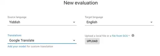

1. Just pick a dummy target language, like English
Let's say the language is Yiddish. Translate the file from Yiddish to English with a machine translation option that supports it. It can be just a .txt file.
דאָס איז אַ פּראָבע.

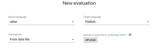

2. Translate to and from the same language*
Create a parallel file, where the "translation" of every segment is just a copy of the segment itself. (They should be separated by a tab and the file should end with .tsv.)
דאָס איז אַ פּראָבע.    דאָס איז אַ פּראָבע.
Then use the other und option and with Yiddish as the target language.
The latter approach is slightly cheaper, since you'll save on the machine translation.
Note that this will work best if the document or corpus is segmented into sentences - one sentence per line. Otherwise, the scores won't mean much.
