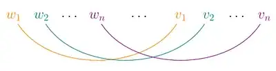

The most frequently given example of syntactic structure that cannot be represented by a CF grammar is apparently the cross-serial dependency represented in the following diagram.
(source wikipedia)
Such a syntactic structure is found in some languages, including Dutch and Swiss-German. Here is a Swiss-German example from Stuart Shieber:

It has been observed since around 1982 that cross-serial dependency is not strongly context-free, which is rather obvious. But there was some debate regarding weak context-freeness of languages with cross-serial dependency. The usual example was cross-serial dependency in Dutch, but there were arguments to show that Dutch was still weakly context-free.
In 1985, Stuart Shieber used the case of Swiss-German cross-serial dependency as evidence of a weakly non-context-free natural language. He used explicit case marking of the language and case based ordering rules for subordinate clauses to show that (the cross-serial part of) the language is weakly context-free only if the language of strings of the form {w a^m b^n x c^m d^n y | n,m >0} where a, b, c and d are symbols, w,x,y are strings not including these symbols, and a^m means a repeated m times.
But this language is known to be weakly non-context-free, as can easily be shown with the pumping lemma.
However, cross-serial dependency can be handled, in the strong structural sense, by a slightly more complex formalism, the tree-adjoining grammars.
