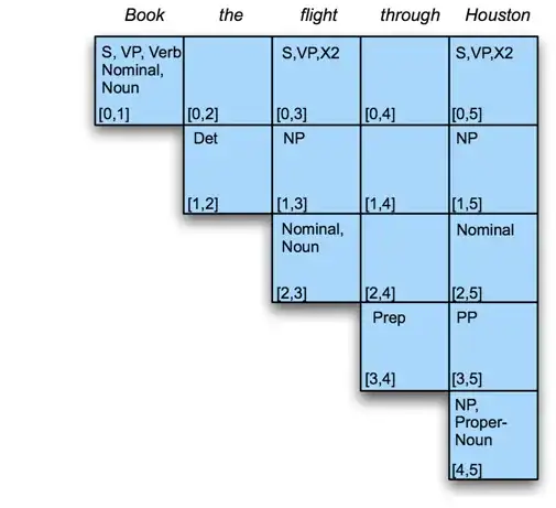

    I've been doing my own research into parsers and grammars on the side for the last few years. This answer captures just about everything I've discovered and articulates in an very understandable manner. I'd upvote this three times if I could. – wjl Dec 24 '14 at 16:24
As you correctly note, ambiguity is rampant in natural language and whatever data structure is used for parsing in ambiguous grammars must somehow represent a large number of possible derivations.
Despite this, it's not feasible to represent every possible derivation as an explicit parse tree, because the number of possible bracketings of a string is its Catalan number, exponential in its length.
Which data structure is used to compactly represent ambiguity depends on the parsing algorithm chosen.
I'll use the CKY algorithm as an example, as the way in which it packs ambiguity is simple to describe.
The CKY parsing algorithm implicitly represents ambiguity using a data structure called a chart.
To focus on your question, I'll leave the description of the algorithm out, only describing how the data structure represents ambiguity. I'll leave a description of the algorithm itself to any NLP text or the video from Chris Manning's Coursera course.
Suppose we're parsing a sentence with N words. The chart can be modelled as a two-dimensional array, in which each cell C[i,j] contains all non-terminals which words [i..j] of the input sentence can derive.
For instance, in the below chart, cell C[0,3] contains all the non-terminals derivable from the words Book the flight using a particular grammar.
CKY chart
The CKY algorithm builds up the chart bottom-up through dynamic programming, so that when the algorithm terminates, the cell C[0,N] contains all possible non-terminals with a yield of the words [0..N].
The key insight that allows the chart to implicitly represent all possible derivations is that any parse tree in which some constituent XP has the yield [i..j] is represented by the very same chart entry in the cell C[i,j].
In the above chart, for example, the chart entry NP in cell C[1,3] implicitly belongs to every parse tree in which the words the flight at positions 1 and 2 is interpreted as an NP.
If each production rule is associated with a probability (a probabilistic context-free grammar), then a decoding algorithm such as the Viterbi algorithm can be used to find the most likely parse given the chart.
Other parsing algorithms for CFGs, such as the Earley algorithm, have analogous ways of packing ambiguity — in an Earley parser, for instance, a data structure called the agenda contains all possible parsing states for a prefix of the input sentence.
It's also possible for a parsing algorithm to discard ambiguity. Since not every possible parse is a likely parse, massive efficiency gains can be realised by only preserving a number of likely parses at each step (a greedy algorithm).
Finally, some parsing algorithms, such as the Chu-Liu-Edmonds algorithm for MST (minimum spanning tree) parsing, do not really represent derivational ambiguity directly. In such algorithms, the set of all possible parses isn't actually stored and thus can't easily be recovered. Instead, the sentence is treated as a graph, with directed edges representing dependencies between words. A tree algorithm runs over this graph to find the maximum-scoring set of spanning dependency edges.
This is sufficient because most parsing applications in NLP focus not on enumerating all parses, but on finding the best parse with respect to some figure of merit.
