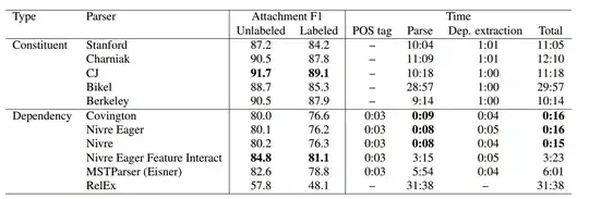

For example, Cer, Daniel M., et al. "Parsing to Stanford Dependencies: Trade-offs between Speed and Accuracy." LREC. 2010. :
Why is dependency parsing so much faster than constituency parsing?

Parsing speed obviously depends on a lot of factors, but in this case I would say that algorithmic complexity is the most important. The transition-based dependency parsers (all except MSTParser and RelEx) use greedy decoding and achieve linear complexity (or quadratic in the case of the Covington algorithm). This should be compared to the constituency-based parsers, which are all based on CKY-style dynamic programming, which is O(n^5) for lexicalized models. MSTParser is somewhere in between. It uses dynamic programming, but thanks to the Eisner style split-head representation it runs in O(n^3) time. The more constrained nature of the dependency parsing problem, mentioned in several comments, also plays a role in that it tends to give tighter "grammar constants" (fewer cases to consider in each derivation step), and it also facilitates the use of split-head representations to reduce complexity.

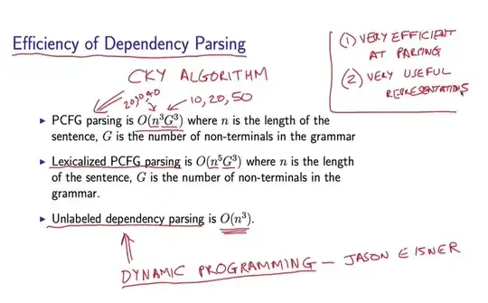

Michael Collins gives a nice explanation in his MOOC on NLP, summarized in this slide:
In short:
Since G (the number of non-terminals in the grammar) is in the order of 50, if your O(n^3) takes 10 seconds to run (in the dependency parsing case), it will take almost 10 minutes if it becomes O(n^3 * G^3) (in the constituency parsing case).
