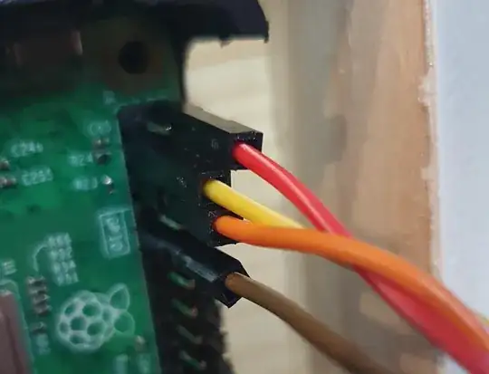

I have tested a 0.9" SSD1306 OLED and found "i2cdetect -y 1" can detect the device address 0x3c without any problem. So I guess there are two possibilities:
(1) The OLED modules you bought are bad.  You might like to buy or borrow more samples to test again.
(2) Your Rpi buster is not properly configured.  As I suggested, you should used another I2C device to make sure your config and i2cdetect -y 1 can indeed detect an I2C device.
I have summarized my test results below.  You may like to use similar config and try again (See Appendix B for more details).

My suggestion: Go ahead with 5V0.
Warning: No guarantee no nothing would melt down or blow up.
PS1 - To troubleshoot, you can try any other I2C devices to i2cdetect -y 1 again, to make sure that your Rpi + I2C driver/software etc are updated/upgraded, correctly setup and enabled, and working. Good luck and cheers.
