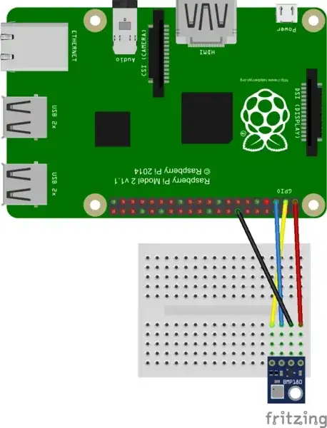

Diagram that I used as a guide to connect the BMP180:
Please note that I did not solder the pins but they are embedded in the breadboard and the wires are connected as shown in the diagram.
Am I missing something or is there a solution to this please?
