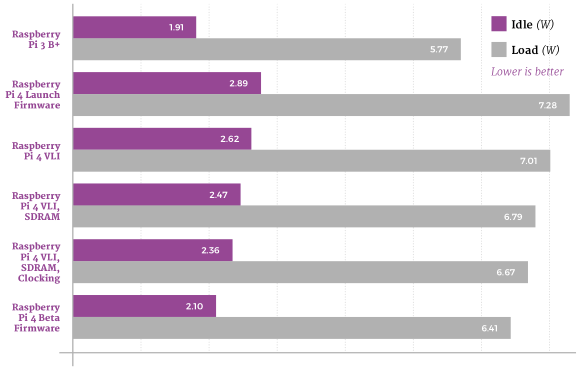

What is the maximum theoretical power consumption of Pi 4? I had expected that I would be able to find some sort of specification table for that, but I could not. The only things I could find were third-party benchmarking results like this which says that Pi 4 uses 7.28 watts on "Load".
But isn't 5V*2A = 10W? Then, why do they say that Pi 4 requires a minimum 3A adapter? Is it because a 5V 2A adapter is does not actually output 2A due to some sort of conversion loss? Or because Pi 4 can use more than 10W?

The amount of power the RPi 4B consumes "under load" is regulated by the device's firmware in a closed-loop system. In other words: At some measured value of device temperatures (CPU, GPU, PMIC), the firmware acts to "throttle" performance to limit further increases in the temperature. We don't know precisely how that is done, because the Raspberry Pi firmware is proprietary. For this reason, empirical limits of power consumption are of more practical interest than theoretical limits.
Test measurements from 4Q 2019 conducted by "The Organization" on the then-current firmware showed that the RPi 4B power dissipation tops out at approximately 6.4 Watts running with the latest firmware as of Nov 2019. However, the ambient temperature of the test environment was not given. It seems safe to assume that additional heat sinks and/or cooling fans were not used, as they are not shown in the graphics or discussed in the text.
The chart in the link in your question was taken from these tests. You can read some details on how they did their testing there. You can also read of similar testing done by an independent group (Tom's Hardware), and notice that the results are in reasonably close agreement. The Tom's Hardware test report indicates the ambient test environment was 24°C, and no mention was made of additional cooling.
