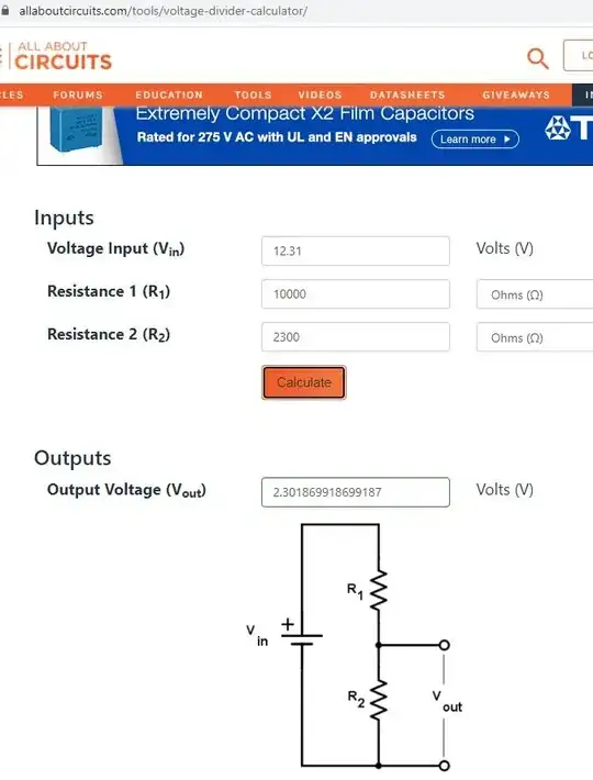

I managed to wade my way to a solution using examples and a resistance calculator - and with the suggestion from @Milliways on going to the GPIO in between two resistors and grounding the second resistor.
Initial power to LED is 12.31V and using the suggested 3:1 or 4:1 ratio from the voltage drop formula, I used R1=1MΩ and R2=330kΩ
Output to GPIO when LED is on now measure 2.34 V which should be safe for the Pi GPIO and a large enough number that my program can sense the change when LED is switched on by button.

EDIT 1 - I had to change the resistors as 2.3V was not producing reliable push button detection. Changed from R1=10k, R2=2.3k to R1=6.8K R2=2.2K to give Vout = 3.0V
EDIT 2: CHANGED RESISTORS Final working circuit on falstad
Final Circuit getting 3.0V to GPIO

  • This looks like my scenario https://forums.raspberrypi.com/viewtopic.php?t=189743#p1193311 and this appears to show Gnd to 12V circuit as well https://www.allaboutcircuits.com/tools/voltage-divider-calculator/ – dbmitch Feb 19 '22 at 04:11
