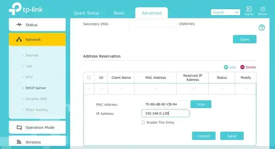

What is a DHCP Server?
For most home network the DHCP server is the WiFi Router. You have to go into the "Advanced Setup" of the router using the web interface to see it. For example:
Your router's setup may look different.
Note, if you plan to use a mobile phone as a WiFi access point, then none of these options may work. A mobile phone's WiFi AP has a DHCP server but it does not follow the rules of a standard DHCP server and does not have any "out of range" addresses for static IP address assignments and does not honor any "requests".
A Router based option
You can reserve a specific IP address within the dynamic address range from within the DHCP server in the router. For this you will need to know the MAC address of the Ethernet (or WiFi) interface of the specific Pi you are trying to reserve an IP address for. For example:
My router allows scanning for MAC addresses and that may help you identify the Pi's Ethernet (or WiFi) interface's MAC address.
Note, if you do this, you will have to select IP addresses within the dynamically allowable IP address range, say 192.168.0.100 to 192.168.0.249.
