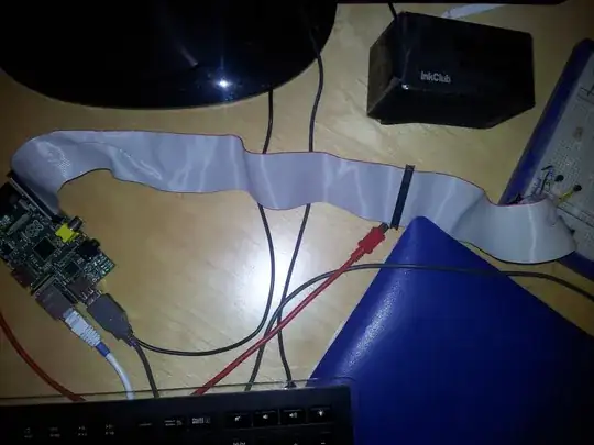

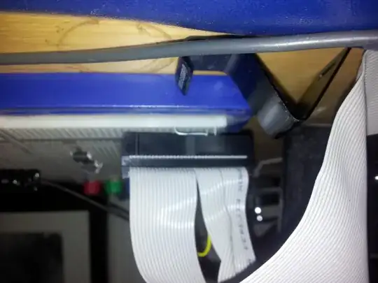

Just wanted to share how I did. Found an old A: (disk drive) flat cabel, connected it to the pi in one end and the other to the bread board. At the bread board end I put some metal thread between the output of the flat cabel and the input holes in the board (inexpensive).
Here one can see the metal going from the cabel to the boad.

                    3Note that apparently *using an IDE cable can be dangerous* for your RasPi! See a comment on hackaday, and a warning in GPIO tutorial. – akavel Nov 10 '12 at 19:17
It is risky to wire so close to the rPi board.
Using an old IDE ribbon cable is less risk.
