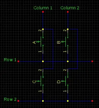

You have to use always one of them as output, and one as input. On the output you let a bit 'walk' from bit 0 to bit n (7 or 15), these are the columns of the matrix. On the other you constantly read the value of the input and these are the rows of the matrix. The combination of what output bit is active and what input bit is '1' is the key that is pressed.

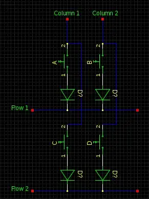

Actually creating the matrix is the most work, and while you are at it, don't forget to add a diode after every switch you put in the matrix, this diode (a normal 1N4148 will do fine) needs to be placed with the anode to the switch and the cathode to the row line. The voltage drop of 0.6V over this diode should not be a problem, the remaining (3.3V-0.6V) 2.7V should still be a logical '1'.

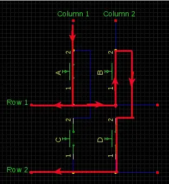

The reason for this truckload of diodes is that it will prevent things like ghosting and masking of keys. Ghosting is the effect that if you press more then three keys at the same time, it is possible that it is interpreted as a totally different key because more rows will have a logical '1'. Masking is the effect that, if you have multiple keys pressed and release a key this will (in some situations) not be detected because the row for that key is still a logical '1'.
The picture shows an example of ghosting, buttons A, B, D are pressed and besides Row 1 (for button A) also Row 2 (for button C) is high, at the moment Column 1 is active, which is not correct.
