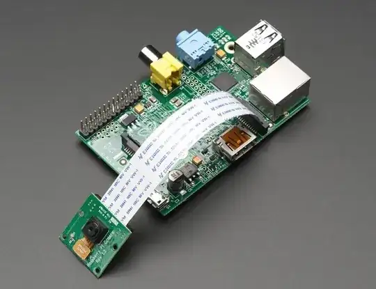

    Ensure that your camera is connected the right way, like this: http://www.adafruit.com/blog/wp-content/uploads/2014/01/1646pi_LRG-600x461.jpg – Werner Kvalem Vesterås Jan 14 '15 at 10:09

For anyone else with this problem... if the light is on at boot then you really might have the wrong ribbon cable port! The cable will fit nicely into the LCD port and the light will turn on and everything. But you will get the error saying to enable the device.
Werner pointed this out: https://blog.adafruit.com/wp-content/uploads/2014/01/1646pi_LRG-600x461.jpg
