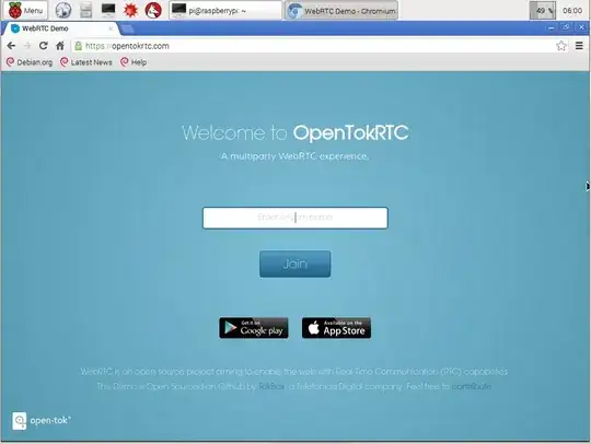

EDIT: Image below of Chrome at opentokrtc.com
Does this mean it works?
EDIT: EDIT: After adding a room it doesn't appear to be responding correctly. However, I wasn't able to get it to respond in a way that I thought with Chrome version 40.0.2214.115 on my desktop. I'm afraid that the jury is out for me. Chromium will install, but the version looks to be too early. I was not able to confirm operation.

  • yeah that's what I feared. A quick test for WebRTC support is to browse to https://opentokrtc.com/ – zabumba Feb 27 '15 at 12:52
  • I've edited the post to include the screenshot of the browser at opentokrtc.org. It appears to be working? – d3noob Feb 27 '15 at 17:04
  • you need to start a room, if your video starts then it works. Enter a string e.g. testwebrtc then click Join – zabumba Feb 27 '15 at 17:11
