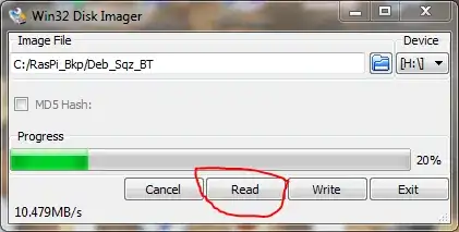

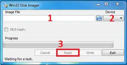

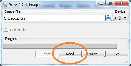

Option 1
On Windows, you can use the reverse process that you used when flashing the SD card.
You can use Win32 Disk Imager, which is the preferred tool for flashing a SD card of the Foundation. Just enter the filename (the location and name of the backup image file to be saved), select the device (the SD card) and press read:
Of course, you can also use RawWrite, dd for Windows or similar tools, the process is quite similar.
