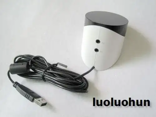

You should look at LIRC. I bought a cheap IR sensor (Philips OVU412000) from ebay and set up LIRC to receive signals from a TV remote in order to control a program I wrote. Works great on my Pi. I haven't looked into generating signals, but I think LIRC is capable of this.

How did you interface the IR sensor to the PI? RS232 or USB? Can you post the specifics? Thanks! – HeatfanJohn Oct 16 '12 at 16:41
The IR receiver is USB and it's connected to the Pi via a USB hub (powered, as I have other stuff connected also.) Do you need any other info? – Munkeh Oct 16 '12 at 18:39
Can you provide details of how you interfaced the IR sensor to USB? Also part number would be great too! Thanks – HeatfanJohn Oct 16 '12 at 19:46
The receiver is a Philips OVU412000. You don't need to do any interfacing as it's all handled by LIRC/kernel stuff; just plug and go. – Munkeh Oct 17 '12 at 20:14
