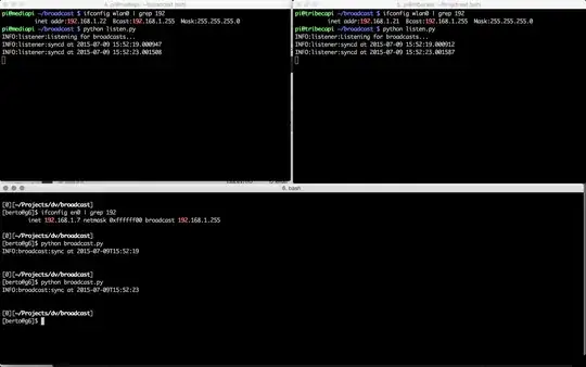

You may be able to get pretty close. My idea goes something like:
- sync time across all RPi's using NTP
 - broadcast a network message to shoot in the future
 - a listener calculates how long to wait and then performs the action
Using NTP you can get all RPi's to be in pretty good time sync with each other. From this Wikipedia article NTP can have sub-1ms resolution on a local network:
NTP can usually maintain time to within tens of milliseconds over the public Internet, and can achieve better than one millisecond accuracy in local area networks under ideal conditions

The listener waits for a message with a timestamp, sleeps until that time and executes the desired action. For example, here's an implementation in Python. If your timing requirements are more stringent, maybe drop to C:

In the code above you can put your logic in do_action() and you're all set.
The broadcaster calculates a time in the future and blasts this on the network. I noticed sometimes the message would be missed, so I have it send it a few times. The listener above ignores any messages that appear in the past. The time delay is set to 2 seconds in the future.

In my quick tests, with a timestamp delay of 2 seconds, the devices are synced within a millisecond:
I like this approach because sync is handled by NTP and messaging is super basic networking. :)

                    1This is a great answer, but still beware that managing to take pictures with millisecond latency consistently cannot be guaranteed -- the OS will get in your way. I'm more optimistic than I was before though, and I think you could get consistent 10 or 100 ms latency this way...which realistically should be enough for almost anything. BTW, I think there is an advantage to using a passive timer with a calculated offset (like you are doing) vs. trying to trigger immediately if the time delay itself is quite long (seconds). – goldilocks Jul 09 '15 at 16:08
                    Thanks @goldilocks. You're right about taking pictures. I approached the question as relating to telling a cluster of RPi's to trigger something at approximately the same time. You make a good point about the OS getting in the way and in that respect turning off any and all unneeded services, e.g. webserver, GUI, etc, will help. – berto Jul 09 '15 at 16:28
                    I think it would be awesome if this did work out that tight, and this is the kind of approach I would try first. I've harped on about the granularity a bit much because I wanted the OP to beware there aren't going to be guarantees -- but I hope I did not create the impression it is not worth trying. Anyway, lots of good starting points here now. :) – goldilocks Jul 09 '15 at 16:55
