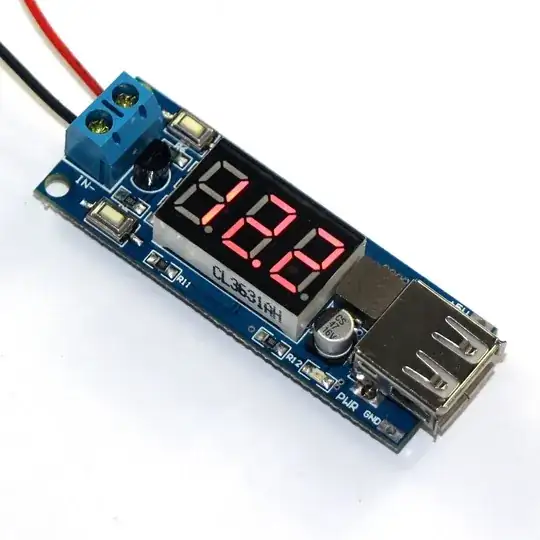

As previously stated you need a DC-DC converter, this DROK® Electrical DC-DC Buck Voltage Converter 4.5-40V 12V To 5V/2A Step-down Volt Transformer Stabilizer Voltage Regulator Module Power Supply Switch Inverter Board with LED Voltmeter 5V USB Charger should work for you:
I got one on eBay to use with two 3.6v Lipo batteries. The 4.8v from your Ni-MH should be sufficient.
