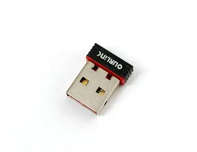

I'm running Raspbmc on my Pi and I use this USB WiFi adapter available from Adafruit.
I had to make the changes shown in this answer to get this interface to come up automatically after a reboot. The driver for this adapter was already in the Raspbmc kernel. It is my understanding that this driver is also in Raspbian Wheezy.
Here's a link to known working USB WiFi adapters for the Raspberry Pi.

I am running Raspbian on my Pi, and I use an 'RTL8192cu' based USB WiFi adapter.
Configuration was easy:
Step 1 - sudo nano /etc/network/interfaces:
(modified for your wireless network settings, of course)
auto lo
iface lo inet loopback
iface eth0 inet dhcp
auto wlan0
allow-hotplug wlan0
iface wlan0 inet dhcp
   wpa-scan-ssid 1
   wpa-ap-scan 1
   wpa-key-mgmt WPA-PSK
   wpa-proto RSN WPA
   wpa-pairwise CCMP TKIP
   wpa-group CCMP TKIP
   wpa-ssid "MYNETWORKNAME"
   wpa-psk "MYNETWORKPASSWORD"
iface default inet dhcp
Step 2 - sudo reboot
When the Pi comes up it should automatically connect to your wireless network.
