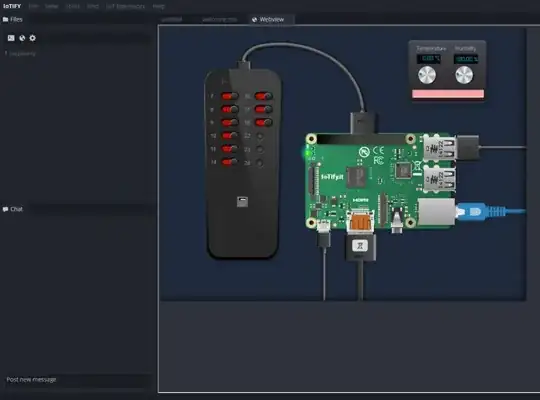

You could easily try my Raspberry Pi simulator included with sensor, command line and file editor at iotify.io. Check out our documentation at https://docs.iotify.io/ to get started with the different projects OS and make yourself familiar with Raspberry Pi working environment.
