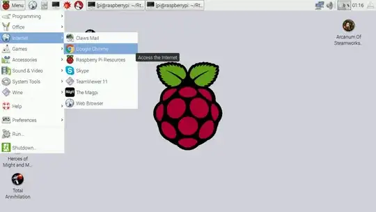

Open Source Chromium is really good alternative for Google Chrome. But sometimes it's needed original Google Chrome. For example, you can't watch video with Netflix or Amazon prime with Chromium because it lack a couple of libraries.
You can install original x86 Google Chrome with help of ExaGear Desktop.
  1. Install ExaGear Desktop (note that ExaGear isn't free and you have to obtain the license)
    tar -xvzpf exagear-desktop-rpi2.tar.gz
    sudo ./install-exagear.sh
  2. Run ExaGear Desktop
    exagear
  3. Download Google Chrome
    wget http://mirror.retrosnub.co.uk/apt/google/pool/main/g/google-chrome-stable/google-chrome-stable_48.0.2564.116-1_i386.deb
  4. Install Google Chrome
    sudo dpkg -i google-chrome-stable_48.0.2564.116-1_i386.deb
  5. Now you can run Google Chrome from Start Menu
Running Google Chrome on Raspberry Pi
Based on this post.
