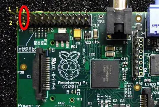

That's not exactly a way to enter runlevel 1, but there is "safe mode" boot option in raspberry Pi firmware. To enable it, you have to insert a jumper between pins 5 and 6 on P1 (GPIO) header when booting.
If you do this, bootloader will ignore the config.txt
file (except from avoid_safe_mode
option which can be used to disable this feature) and will try to boot kernel_emergency.img
(if available) instead of kernel.img
Default kernel_emergency.img
has special emergency initramfs
build in and it will boot to this busybox based OS so that you can fix the problems in your OS manually (or change kernel boot parameters to run runlevel 1 at next boot). Remember to run sync
before powering down since reboot
or shutdown
commands may not work.
