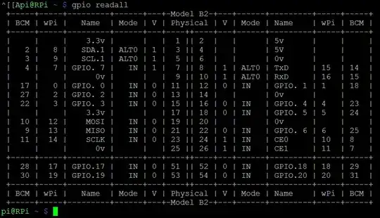

gpio readall will show state.

                    @Milliways So I got that working, I understand all the columns except the "V" column. What is the supposed to mean? – Peter Zhu Nov 10 '15 at 23:25
                    @Milliways I just found out that the "V" column is for values. So I have either a 1 or a 0 value for that column. What does that mean? – Peter Zhu Nov 10 '15 at 23:29

        I just got I2C and WiringPi installed a few hours ago. To expand on what @Milliways said, I rebooted and checked the output of gpio readall. See the attached image. It appears most all the pins start as inputs.
