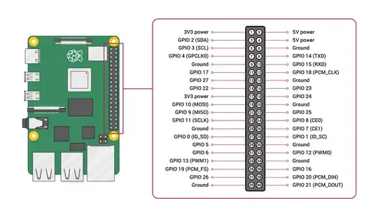

Now connect your computer to the Pi as:
You only need to attach 3 jump wires:
- Ground to Ground
- Tx on Pi to Rx on the USB to serial port
- Rx on Pi to Tx on tye USB to serial port
But if you have 4 ump wires laying around, you can also connect the VCC port which then allows you to also power the PI through the USB, this way you only need to plug one thing into the Pi and it starts running, which is very handy.
This is also documented at: https://www.raspberrypi.org/documentation/usage/gpio/README.md which also contains a pinout for the RPI:
Be careful not to link the Ground to the 5V, I've already burned 2 UART to USB chips by doing that!
You don't need to connect the 5V to the 5V at all. I think you can power your Pi like that, but I've read that this is a bad idea, just use the usual USB power source.
