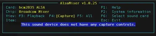

I don't believe the Raspberry Pi has the necessary hardware to capture audio input. You can confirm this running alsamixer.
That would explain why alsaaudio.ALSAAudioError exception was thrown by alsaaudio.PCM.__init__ method.

  • Mhm. Running alsamixer I do not get the capture controls message shown above. Instead, a volume control is shown? – andig Dec 18 '12 at 12:08
  • Press F4 for capture controls. F3 for playback & F5 for all controls. Use F6 to switch between sound cards. – emcconville Dec 18 '12 at 14:10
