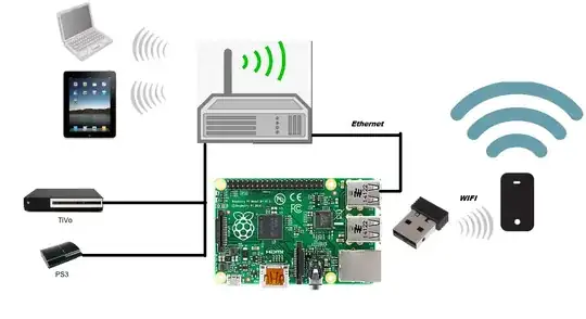

Let me describe what was my needs and how I achieved what I needed.
Need
Connect RPI to WiFi using WiFi USB adapter and share internet connection to Ethernet cable, connected to actual router. RPI configuration done via SSH.
Steps
Insert WiFi USB adapter and internet cable to RPI. In the following steps - WiFi adapter will be called wlan0 and Ethernet interface will be called eth0.

- Connect Ethernet cable to Router (so it's RPI <--> Router) and use the following WAN settings in router configuration page. Note that RPI does not have DHCP server, so you need to use static IP:
