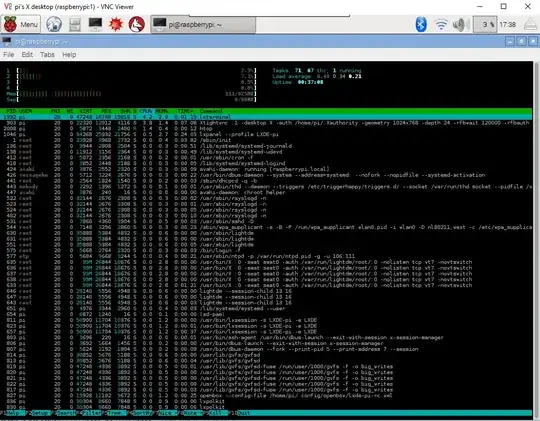

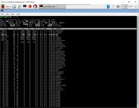

You can get a real-time view of memory usage using either the top
or htop
command. You may need to install htop
if you get the message htop: command not found
. Assuming you are using Raspbian, install it by running sudo apt-get install htop
- 842
- 7
- 10
1htop seems to be "better" http://htop.sourceforge.net/index.php?page=comparison – Scoop Jan 08 '13 at 00:15
Plus, if you are using a multi-core machine such as RPi 2 you see the load for each core in a nice bar graph, and for example when you see 'python' in the list of tasks it shows the entire comamnd line so you see which program is running – jpw Jan 23 '16 at 22:39
@jpwynn Note that with
top
you press1
and you see all processors too. But I agree thathtop
is generally better/easier to use. – Alexis Wilke Mar 14 '18 at 02:11

To monitor the CPU, RAM and SWAP usage in Raspbian, you can use TOP or HTOP.
In terminal, run top
. TOP is available by default, and gives reasonably good details.
But, I find HTOP to be more useful, with better details and features available. HTOP is not available by default, and need to be installed.
Run sudo apt-get update && sudo apt-get install htop
in Terminal to install HTOP.
In terminal, run htop
after the install is completed.
Hope that helps.
