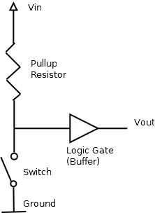

Here's an example of a pull-up resistor schematics.
A pull-up will make sure the pin is up without taking in too much current. A gate has three possible states: ON, OFF and FLOATING.
The FLOATING state is not very useful since it can't be converted to a boolean value. Hence pull-up and pull-down resistors: they are there to eliminate the FLOATING state.
