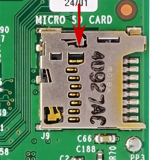

To begin with, bend the J shaped piece of metal (circled in the image below) on the micro SD card slot backwards (in the direction indicated by the arrow on the image below) lifting the free end.
An image of the SD card on the Raspberry Pi 2 Model B, with an arrow indicating the way to bend part of the housing to gain access to the spring. (Image based on the photo by Multicherry on Wikimedia Commons, CC-BY-SA.)
Then insert a thin probe (I used a safety pin, but a paper clip should fit) into the gap opened up and push the spring and plastic clip downward (in the direction indicated by the arrow on the image below). The spring and clip will separate and come free. Using the probe, remove the spring and the clip from the SD card slot.
An image of the SD card on the Raspberry Pi 2 Model B, with an arrow indicating the in which direction to apply force to the spring.

After the spring and clip are removed, you can bend the J shaped piece of metal back to its original position. The card slot will now work, but you'll need to push cards all the way in to seat them, and pull them out by hand to remove them.
