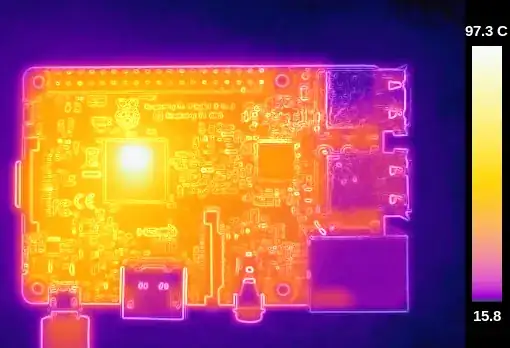

Please don't forget that overclocking is a gamble , your Pi might not be overclockable , crash and corrupt SD cards.
Active cooling is highly advisable while overclocking the Pi3 :
picture of heat distribution on a RPi3
