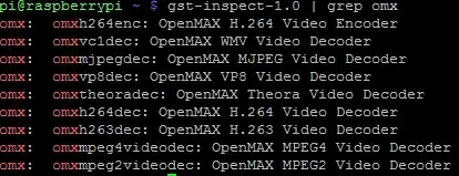

Verify that gst-omx has been installed correctly.
If it has the following command should show these plug-ins:
> gst-inspect-0.10 | grep omx
openmax omxmpeg4videodec: OpenMAX MPEG4 Video Decoder
openmax omxh264dec: OpenMAX H.264 Video Decoder
