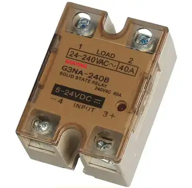

And if the motor is so big, that the inrush current might get a problem : use a solid state relay! Solid State Relay
