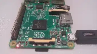

Fully automated minimal bare metal blinker example
Tested on Ubuntu 16.04 host, Raspberry Pi 2. Usage:
  1. Insert SD card on host
  2. Make the image:
    ./make.sh /dev/mmblck0 p1
    Where:
    • /dev/mmblck0 is the device of the SD card
    • p1 is the first partition of the device (/dev/mmblck0p1)
  3. Inset SD card on PI
  4. Turn power off and on
GitHub upstream: https://github.com/cirosantilli/raspberry-pi-bare-metal-blinker/tree/d20f0337189641824b3ad5e4a688aa91e13fd764
