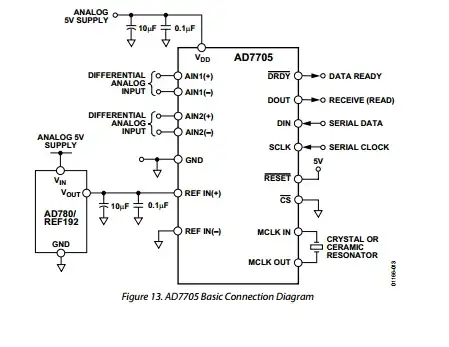

For beginner electronics engineering, the use of clocks and all that terminology can be easily misunderstood.
All it means it needs some sort of external frequency so that it can synchronise its internal logic. This can be a crystal, timer or another real time device that can generate pulses in a timely fashion.
It can NOT be a Pi- Unless you use a Real Time system on it; atMega or aTiny are a good source of variable frequency generators but the cheapest are crystals.
In this case the 2.4mhz to 5mhz spacing is a way of controlling the execution speed. Sometimes it must be matched so that you can calculate baud rate- for example serial connection or SPI.
This is a very good data sheet with lots of graphs and data - that might not make immediate sense to you but the first thing to look for is a typical application / basic connection diagram. Later you will find asking more question that the graphs and tables will provide you with answers.
You can clearly see they use a CRYSTAL OR CERAMIC RESONATOR as a clock input.
Connection a crystal directly is permitted for testing only. In production you really need to balance the crystal with matching capacitors so that the freqauicnies do not stray- which chould lead to data corruption or communication problems when the environment changes (temperatue, humidity and pressure) Because testing is short term you will not if hardly see any variation in frequencies from a crystal.
So which crystal should you use? Well- Only the data sheet can provide that answer. It all depends what you want to do. Faster does not mean better.

    Thanks so much for the insightful answer. I've ordered a handful of 4mhz ceramic resonators to provide a stable clock source. It appears they're less sensitive to environmental variations and include the necessary capacitance. It seems the SPI clocks are driven separately on this, so I can dictate the signaling rates on the RPi. – patking Mar 20 '13 at 04:02
