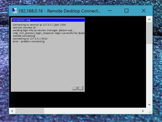

I ran:
sudo apt-get update
sudo apt-get install xrdp
I wen't to Windows 10 remote desktop connection and connected to my Raspberry Pi 3:
Then I entered default credentials credentials (pi/raspberry) and I got this log:
The login was successful but "Problem Connecting"... not very informative I'd say. Anyone knows what to do with it?

  • Any chances of checking the logfile to get a more informative message? – Dmitry Grigoryev Oct 17 '16 at 12:36
    Doing just sudo apt-get install vnc4server, followed by either a reboot or a sudo service xrdp restart fixed it for me, but the mouse is an x instead of a mouse pointer like it should be. I'm doing some more experimenting now. PS. This is on my new Pi 3 with Raspbian Jessie installed from the latest v2 NOOBS installer. I never had any issues with xrdp on my Pi 1 B+. – Gabriel Staples Oct 17 '16 at 18:27
  • @Andrei, can you edit your post and specify "Pi 3" please in your title here? I see you've got it in your tags, but putting it in the title too I think is important because this problem definitely doesn't exist on the Pi 1. It has to do with the fact that the Pi 3 now comes pre-packaged with RealVNC, which conflicts with both xrdp (which uses vnc4server) and tightvncserver. – Gabriel Staples Oct 18 '16 at 13:25
  • @GabrielStaples sure, done! – Andrei Oct 18 '16 at 19:35
  • @GabrielStaples it probably has less to do with Pi 3 and more to do with the version of Raspbian. – Leif Gruenwoldt Mar 29 '17 at 14:03
