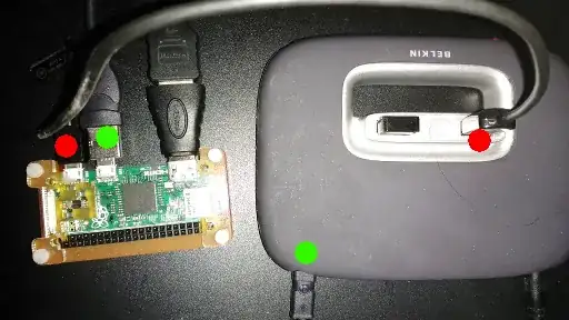

The yellow is the HDMI cable, the white cable is the power cable. and the USB hub is attached to the USB OTG cable. Anything attached to the hub is not detected.

Here's two variations on the normal hub. In the first picture, the Pi is powering the hub:
A is the data line coming from the hub. It is connected to the data jack on the Pi. It's mostly hidden in the picture, but I'm using an OTG adapter on the other end that fits inside the normal size male end of the data cable, so what you can see is the smaller micro B jack sticking out of it into the Pi.
B is an RF keyboard/mouse transciever I used to test that the hub worked to provide slave devices. C is the power supply to the Pi, which is used to power the hub.
It can't be seen in the picture, but the hub is unplugged (there's a third variation on all this, since it also works with the hub plugged in but the pi powered separately).
Here's a variation on that where the hub is powered, and used to power the pi, but this requires two cables between the hub and the pi, one for the data line and a normal one to provide power.
The green dots are at either end of the data line (of which, again, there is only one per hub). The red dots are at either end of a normal microUSB cable used to power the Pi.
I would guess that if the hub is plugged in, it disconnects the power from the data line so there are not competing supplies. I'd also guess that any hub which can be used this way does the same thing, and that most powered hubs can be used this way. But I don't know for sure. In any case, it did not explode for me ;)
One thing you should be sure of: DO NOT PLUG TWO NORMAL PORTS INTO THE PI THIS WAY. One is okay. The other one here is the hub's data line.
