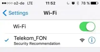

I'm using my pi3 to display a local "website" as described here Making a Raspberry Pi 3 accessible w/o configuration via WiFi and static IP/URL.
Therefore, I'm creating a hotspot with the pi. This hotspot has no connection to the internet. Thus, (correctly) all devices show the connection as broken, connect forever or drop the connection after a while. => SOLVED see Edit I Now I want to forward the devices which connect to this hotspot to my splash page.
I was wondering if I could configure the hotspot in a way that my local website is the login page.
Example,
this hotspot first connects and then opens up automatically a login page:
1 Connecting
2 Connected
3 Login Page
How to configure the hotspot in a way that devices are automatically forwarded to http://localhost:80 on connecting.
