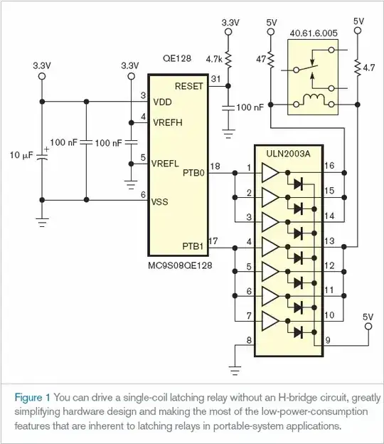

The easiest way is to use a 2 stage driver. You need to use a high voltage relay driver such as ULN2003 ULN2803 and then connect the output to drive a relay to control your desired component.
You can buy all those components on Mouser or DigiKey or any other major site. Just be warned that these components draw a lot of current, so you can not use the 5V that is available on the expansion connector, you need to have an external power supply with at least 1A power @5V.
Note: The reason for suggesting that a relay is used is that the Raspberry PI does not have enough power to drive that many transistor outputs, unless you use a FET transistors. A driver circuit makes sure you don't damage your precious RasPi even if you short the output or have a power surge due to the rush current of the relay switching.
