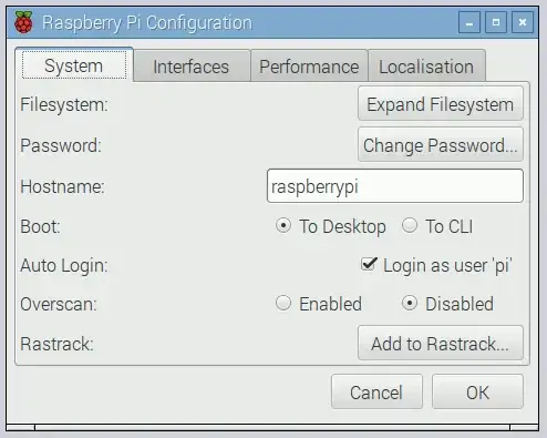

Please go to your settings menue on raspbian (upper left corner) and check if SSH is enabled.
Upper right corner -> configuration -> interfaces -> SSH -> enable
config
Alternativly, you can enable it as follows: http://raspberrypiguide.de/howtos/ssh-zugriff-unter-raspbian-einrichten/
It is in German, but just follow the pictures
