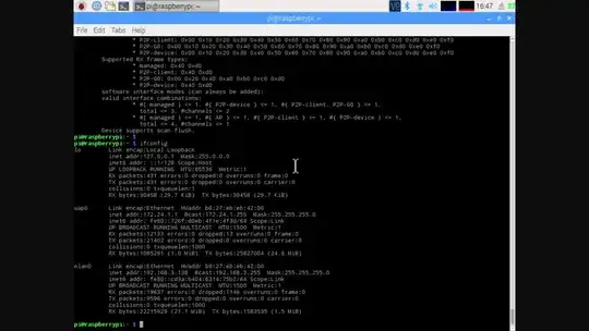

It is perfectly possible, my Pi Zero W does so, but the client and AP must use the same channel.
See a screenshot from my ZW:
The output from your iw list shows that only the second combination allows managed (i.e. client) and AP at the same time , but it says channels <=1. That is, they need to use the same channnel.
I have used the guide from http://imti.co/post/145442415333/raspberry-pi-3-wifi-station-ap (which is the same linked by Alfredo Pons Menargues) adapted to my own needs.
  • Did you significantly alter the instructions from your posted link? I'm trying to replicate with a pi zero w and Raspian Jessie, but struggling to get a static ip assigned to the uap0 interface – tomtomnz May 11 '17 at 04:11
  • @tomtomnz, do I didn't. – Javier Sedano May 11 '17 at 09:00
  • It is very important to use the SAME channel number in hostapd.conf as you use for your connected wireless network. I.e. you need to connect to WiFI first, find out which channel you're using (iw wlan0 info), and write this channel in hostapd.conf. If you connect to a different network, and channel changes, your setup will break - you'd have to change your channel manually again. – George Y. Jul 07 '17 at 05:59
