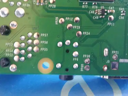

I heard that you can solder rca/3.5mm terminal blocks to the pins of the audio/video 3.5mm and connect it to a/v compatible displays and also connect the audio pins with an audio amp/4-8 ohm speaker...
I checked several sources, but many claim different Things.. Most say that the 3 pins under the 3.5mm
Are left audio, video and rifgt audio from left to right. Is that true?
