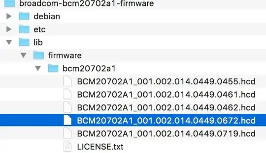

My Bluetooth dongle is Targus 4.0 (ACB75AU)
I had a similar problem and ended up having to download a set of broadcom firmware. https://launchpad.net/bcm20702a1
After extracting the software i got a bunch of folders, the one of interest being lib > firmware > bcm20702a1. It looks like it has a few versions of firmware in there. I took the file named BCM20702A1_001.002.014.0449.0672.hcd and copied ti to my RaspberryPi B 2 into the folder named /lib/firmware/brcm. The file needs to be renamed to BCM20702A1-0a5c-21e8.hcd.
After that you can take the bluetooth dongle out and put it back in and it should work. If not, power-cycle your Pi.
Run service bluetooth status and hciconfig -a to get more info on the status of your device.
Here's the file I took from the archive. I tried the last file, but it didn't seem to work, so I went to the one before that assuming they are just different versions of firmware for the same device.
