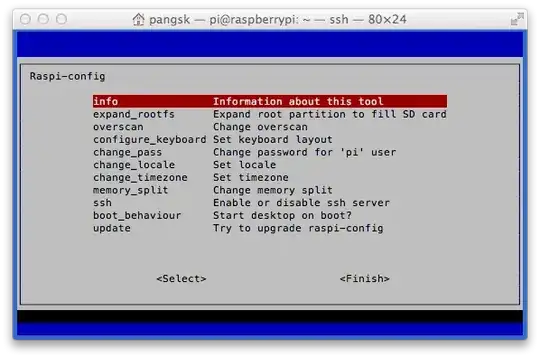

Assuming that you are using Raspbian, it is actually rather simple to do what you ask. Simply open the terminal, and type in the following:
sudo raspi-config
The following window should show up
Config Screen
Navigate to boot_behaviour and click enter. This should make it so that the GUI interface starts automatically.

  • Just a detail: My feeb attempts to switch back, from boot-to-gui to boot-to-shell, failed. Maybe I started with an obsolete Raspbian image... – Phlip Jun 16 '15 at 16:11
