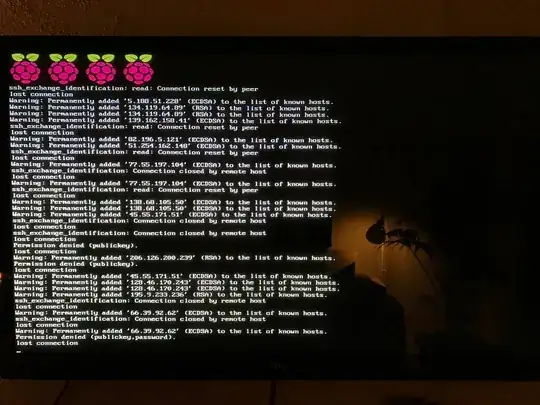

When I then boot the RPi normally, I see how, in the process, inmediately after stating:
zmap is already the newest version.
0 upgraded, 0 newly installed, 0 to remove 1 not upgraded-
The following never ending process starts:
Oct 20 17:54:20.561 [INFO] zmap: output module: csv
But the process gets interrupted by telling me that some hosts have permanently been added? Is my little computer being hacked?
Then the process starts over and over, sometimes reaching 100%, but even though starting again. I even get a message from some NCDev/PLUR stating:
WELCOME TO NCDEV.
This is a secured computer network and only authorized users are allowed.
If you are not an authorized user please disconnect inmediately.
Note that all connections/IP addresses are subject to review by the system administrator and your connection to this network may result in your connection being probed to maintain the security of this network.
Before I format and reebot my RPi I wanted to ask you guys, if there's anyone that knows what is going on here.
