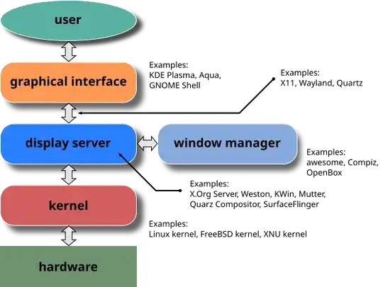

The way that the GUI is rendered on a Linux system is relatively simple, once you understand what each part does. We don't need a really in-depth knowledge of each part, but I'll give you a brief summary, with the aid of a nice illustration I found:
Display stack
Illustration of the graphical user interface stack by Shmuel Csaba Otto Traian; CC BY-SA 3.0.
  • The display server (in your case X.Org) handles the primitive drawing and events such as mouse/keyboard input. Generally, you wouldn't bother writing your application to talk at this level, because it's a lot of work. Interesting trvia: a lot of newer distributions are considering using Wayland instead of X, because X is getting old and complicated... Not much fun to work with!
  • On top of your display server is your desktop environment (which is LXDE; PIXEL is just a modification of it). The desktop environment also has a window manager, which handles drawing the chrome around your windows (shockingly enough!).
  • Applications such as yours generally use a GUI toolkit. This contains some basic widgets such as buttons, text boxes and so forth which are useful in many situations. The famous two are GTK+ and Qt. This is the important bit for you.
